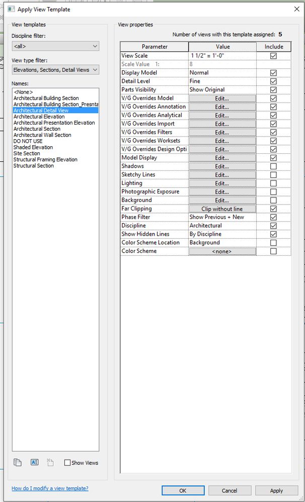

I'm having an issue with my detail views - I have 4 detail shots of different wall sections, some of which share the same section. 2 of the views show up just fine while the other 2 are showing as Raster Images??? All 4 views share the same view template and 3 of the views share the same section! I've checked everything (depth cueing, far clipping, shading, model views, etc) for any inconsistencies and nothing seems to be working! It's a pain in the butt to spend so much time in developing proper lineweights and views for these drawings for Revit to only turn around and rasterize it!

Take a look at the top two details - both of these are showing perfectly. Lines are lines, line weights are shown appropriately, the whole detail is crisp. The take a look at the bottom 2 - these are almost "greyed out"and have lost a lot of detail in the linework. The bottom two are printing as rasterized images and not vector graphics.

The lower details are definitely plotted as raster. To OP: is the Visual style controlled by the view template (box checked)? Can you post a screenshot of you view template settings?

Thank you for the pointers! In fact - they do all make sense, but sadly still nothing that would force the rasterized view. In fact - the bottom two details are callouts of the same wall section as the one above it. All 3 views are callouts of the same wall section.
Here are a few screen caps of what I'm working with - keep in mind all 4 views contain the same properties.
Message 16 of 24
Not trying to question your screenshots, but there's something not quite right with what you posted. The 'Include' checkboxes in the View Template dialog are not checked for Sketchy Lines, Lighting, Photographic Exposure, and Background. Yet they are grayed out in your Graphic Display Options, which typically indicates they are being controlled by a View Template. Since they are not included in the View Template, you should be able to control those options per view.

They are greyed out because Revit only allows you to edit the "value" of which you clicked on - meaning, if you want to edit the model display within the template, you can only edit the model display section, forcing you to go into each tab and manually change the properties. Despite all the boxes being unchecked that would force a raster image, I am still getting them when printing. I screen capped that just to show the full menu showing that there is nothing that would force the drawing to be rasterized.

To Segway on what @Anonymous says - check the boxes but Edit to disable Sketchy Lines, Lighting, Photographic Exposure, and Background. Aslo do the same for Shadows, Sun, etc.

I've got a floor plan view that was printing raster. And another one that was printing vector. And I went through EVERY setting. As far as I could tell, they were the SAME. I checked over, and over, and over again.
I couldn't figure it out. I hid categories one at a time until there was almost nothing left. Still raster. I isolated a single text note to be the ONLY thing in the view. Still got the raster warning.
I fixed it by making a View Template from the view that was working correctly, including EVERY check box possible, and then applying that View Template to the problem view. And then since I wanted control back I un-applied it, but it was okay. Whatever it was had been corrected.
