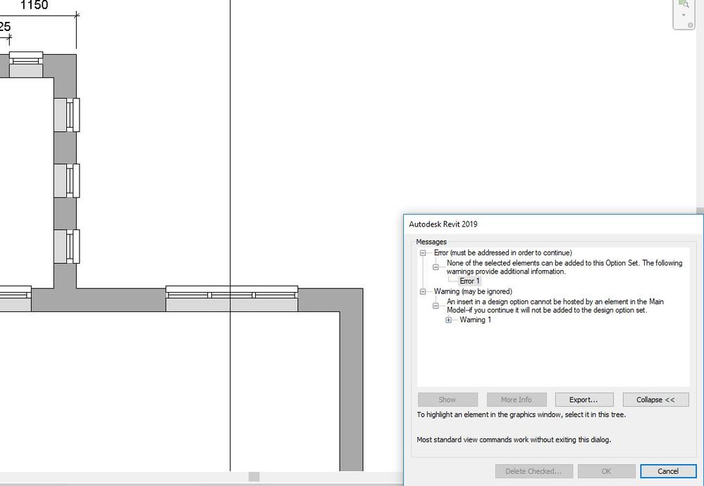

Hi, First time trying Design Options.  But it won't let me do it as per the below.  I want to put the group of 3 windows as option 1 then have option 2 as 2 windows and a door.  I created the 2 options as sub headings under the Option Set 1 heading.  Clicked on the windows and which then allowed me to click the Add To Set button but when I click the relevant set I get this error. Can anyone let me know what I have done wrong please.  Thanks.

The door/window cannot exist without a host. The wall that is hosting the door/window must be included in the Design Option.  So, in this case, you need to create a host wall for the door and another for the window, and include one wall host in each Design Option.
