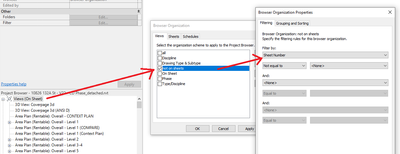

Easiest would be etransmit as @ToanDN said. However you can also use the browser organization to filter views that isn't on the sheet. Once this is done, you can simply select the views and delete them.
