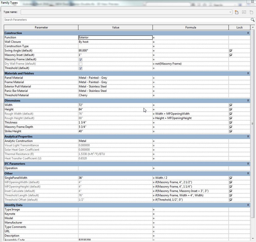

Thanks Felipe.  I do know how to do that.  I guess I didn't explain it correctly.  The Scheduled values are set up in the project and link to the schedule.  So they don't actually show up0 in the family them selves.  See attached file showing all I can see within that door family.   Do you see what I mean?  See also the first photo I posted. One door family has default values set for Frame Material Scheduled etc and the other one doesn't. Thanks!2017-02-03 13_36_11-Family Types.jpg
Message 4 of 10
If you want to enter these fields in the door family, the you need to bring the shared parameters in the family.
If you only need to enter the value for these fields for these doors in the project environment, via door properties or door schedule, then you don't have to do so.
