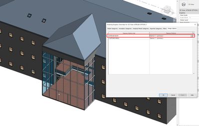

Sorry, I'm not following you, buddy.  I did exactly what you described before.  Clicked Exclude, TAB-Selected the 3 Walls, Copied them to Clipboard, Pasted them Aligned to Same Place and then put it into Option 2 of the Atrium Design Option Set.  Afterwards, I Attached them to the Atrium Roof.
Is the View's Design Option to Atrium Set Option 2?
Message 12 of 19
As I have said above, you need to change to Main Model in order to select the main model elements to copy paste.  Uncheck Exclude Option does not do the job efficiently, if at all.
Message 13 of 19

Are you asking how to make the Atrium Roof Option 2 the Primary? If so, go into the Design Options, select the Atrium Design Option 2 and press "Make Primary".
2. how do i change roof to change to the new atrium roof?
Are you asking how to create a View which shows a particular Deign Option? Go to the View's Visibility and Graphic Overrides Design Option Tab and set the Design Option you want the View to show (not "Automatic").  It's called a "Dedicated View".
Dedicate Views to a Design Option | Revit Products 2016 | Autodesk Knowledge Network
