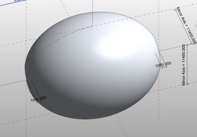

hello, please refer the below link.
https://knowledge.autodesk.com/support/revit-products/learn-explore/caas/CloudHelp/cloudhelp/2014/EN...
My question is how to change the grid orientation (Making the top as center not edge). mt model is more like ellipsoid.
The mass family is in the attachment.
Thank-you in advance.

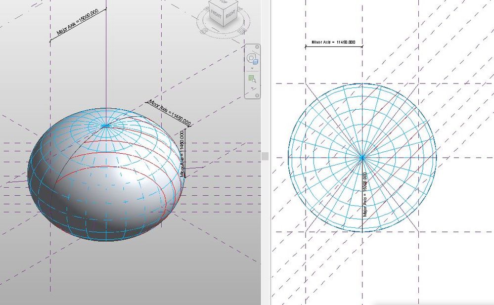

A grid like this.

Draw your "egg" on a different work plane.
...or Revolve about Axis:

I hadn't noticed that you posted your file. I just downloaded and examined it.  It is definitely a bigger challenge than I first thought.  I don't know that it is possible with that shape.
Wracking my brain right now.

Divide the surface using intersecting reference planes.

no pattern can achieve that result.. only option is to use reference planes..
As @ToanDN mentioned.. create Reference planes on plan..
and then Use " Intersects List"
Intersecting Named ReferencesIntersecting Named References

Are you sure? I couldn't get Intersects to make that Divided Surface.

I think the trick was to copy the REFERENCE PLANES CENTER ( Front / Back ) or CENTER ( left/Right )
using new reference planes it doesnt work it seems
1-Copy of Center Planes.JPG1-planes.JPG1-refrence planes used.JPG2-divide surface.JPG

I think the best possible solution is a "donut" shape.
On the ref. level draw 2 ellipses , 1 for the outline , 1 for the gap.
Create Divided Paths from those ellipses.
Make a 2 point Generic Model Adeptive family of a halved ellipse, and place on the divided paths.
Make a repeater to create the "skeleton" for your shape, and remove repeater.
Make the 4 quadrants into a surface.
Chop the ends from the resulting shape.
Select the joined geometry faces and make a Divided Surface.

I tried to do the same but i am not able to create quadrants and I need it to divide it into 16 parts not 4.
Is their a way to divide path in equal angle not in equal length.

That why you need to use reference planes.. array in equal angle ..

to make the quadrant:
select a number ( in the example 9 ) adjoining instances of the 2 point Generic Model Adeptive family of a halved ellipse, and [ Create Form ]

Thank you got it.
