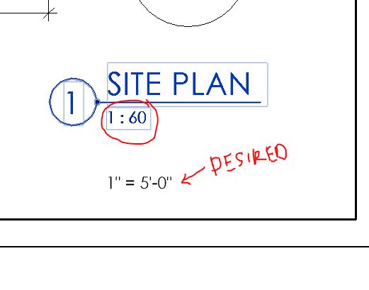

Firs time poster - long time Revit user
Downloaded Revit 2017 and want to be able to rename a custom scale. In previous versions I thought a dialog box popped up and we were able to rename the scale that way. I don's see this option in 2017.
Any help would be appreciated.
Cheers, Alex

No renaming scales. Always set the scale to custom for your view and enter an value
Or are talking about some different scale settings?

We're on the right track.
If I add a custom scale of say 1:60 but want the view to read 1"=5'-0", I always thought there was a way to rename the scale..

What you are showing is a view title family. That, by default, reads the value from the view (as shown in my post above).
In the view title family it uses a label to read the view scale parameter. You could change your project to inches to see scales in inch formats.
Otherwise it would be editing the view title family, remove the view scale label and add your own parameter.
However you would have manually enter it in each view as it does not read the existing view scale.

When you choose "custom" from the scale list you get a dialog where you can specify a display name for the scale if you wish.
