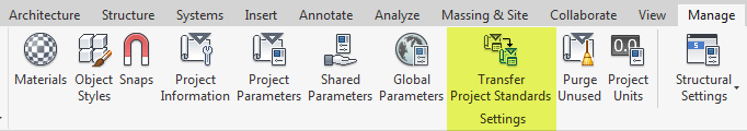

I don't understand your question. Are you asking how to transfer a customized system family from one project to another? Use Transfer Project Standards on the Manage Tab.

 Transfer Project Standards.
