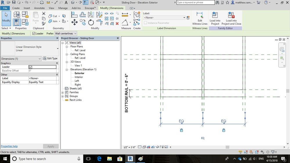

Hello all,
I cannot seem to get these sliding curtain wall doors to be equally aligned. (To have the center stile in the center of the panel).
I have locked the equal constraints as seen in the picture, and also aligned the doors to the outside.
How can I align it as desired?

I messed with it a bit. Got it to work finally. Try unpinning the Centerline in Elevation and flex it in width to break whatever constraint is that you have there.
...Let me know if that does the trick. I did some other stuff too, but it may not beneccessary to duplicate that work. Oh! and unlock the EQs.

The centerline in the family if off origin.  It's a known issue from the family template.  See similar thread here:

You can test it yourself by copy the center L/R reference plane from a OOTB curtainwall door sample family and paste on to a new family started from the curtainwall door template and see the offset.  The OOTB sample family is correct, the OOTB family template is wrong.

Had the same issue, unchecked "define origin" on the center ref. plan, unpinned it, moved it, place equal dims back on it, then check "define origin" again.  worked.
