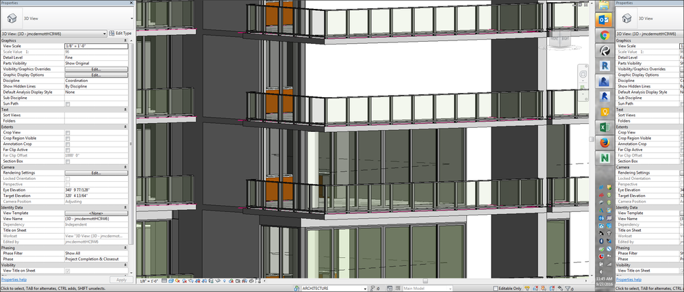

I have a model that was outsourced and am updating myself. It had previously consisted of a Central Model that linked back to several other models. I have since bound all these models (not ideal, but works better for me in this instance). This was working fine, but recently after updating the model I noticed that some of the sliding door panels now no longer cut the CMU Walls they were placed in. The model they were linked from was for levels 08-38, but the problem doesn't start until L09. The problem also is not present on all of L09; some of the panels there are still visible. Additionally, if you select the L09 Group before editing it, you can see the Sliding Panels within the CMU wall.
Has anyone come across this issue before? I've tried changing Visibility Settings, Worksets, and any other suggestion I could find online, but I can't get these doors to show in any view.

I don't know how that happened, but you can use Cut Geometry to fix it.

I could not get that to work either...

Maybe you could save a troubled model group to a Revit project file and upload it here.
