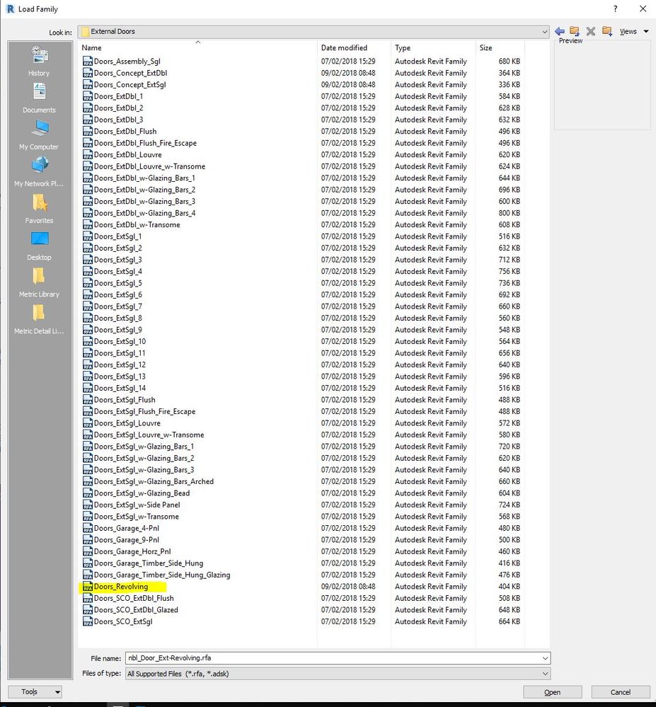

Hi! Struggling with the curtain wall revolving door. Following a tutorial, I try to insert a door by 'Load Family'. Now in my Revit there's not curtain wall door options like the guy in the tutorial has so I downloaded my own from NBS BIM and other sources but non of them seem to work even if they're in the same directory. Revit keeps giving me the same error - at first *Update message* - your software is updating; then I get the *Cannot Load Family Files* window that sais I have to choose family files of the category Doors - which I did?! Help pls

Should have mentioned - yes, I'm putting these into a curtain wall. Watched numerous videos on this - not sure where I'm going wrong. Please see the image attached. I think it might be a problem with that objects from the directory are somehow not working as for other people. I keep restarting my computer but nothing is resolving this. Please see the pictures. The second picture - I tried to add the downloaded door to the original list but it is not working either. There are no curtain wall options in the original list eitherrevit rev door probs.JPGdoors.JPG

Okay great - I can open your file with the doors in it but still, I cannot 'Load Family' the same door! Can you tell me how you did it? I select Architecture - Door - Load Family - the door I sent you from the Door directory but still get the same message about the 'must choose family files of the category Doors'
