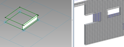

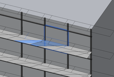

I'm working on a simple skin. Something like:
Here is the result of ten hours of misguided work:
Here is what the panel is supposed to look like:
I believe I setup the constraints correctly (to the best of my knowledge), using the align tool and aligning reference lines to the normal planes on the adaptive points. I think I am missing some key understanding. Using Revit 2015.
I attached the files, and I was wondering if anyone would be kind to give me a few pointers to get me on the right track. Thank you so much!

I understand the process very well. What I don't understand is why there is no geometry. The "skin" shown in the top photograph is a series of vertical louvers. I don't get what you're doing. I see no louvers.
Nachricht 5 von 7
als Antwort auf: barthbradley
I tried the vertical louvers, and that came out even worse (had a terrible time constraining them in the z-axis):
For now I just wanted to have a series of 2d surfaces I could use as the base for the louvers later, and for if I wanted the louvers not to stick out but be just flat panels. I thought that would be a problem I would be better equipped to solve.
I've used generic family templates where I would setup my own, much more complicated constraints (no adaptive points), and it seemed much easier than this, I don't know why though.
Nachricht 6 von 7
als Antwort auf: Anonymous
Getting the hang of it; it was essential to read the attached pdf (AU BON PANEL: BAKING YOUR OWN ADAPTIVE COMPONENTS AND PANELS WITH REVIT):
I found it through http://bimtroublemaker.blogspot.com/2011/03/family-abuse-curtain-panel-by-patterns.html
Nachricht 7 von 7
The PDF linked in the previous post made all the difference.
