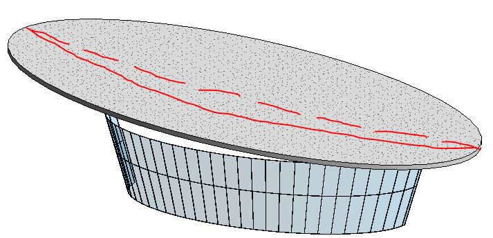

Can anyone direct me to a tutorial video that shows how you would go about creating a sloped elliptical roof that curves in the Z plane? I also created walls with the Curtain System but don’t see a way to extend them to the roof as “normal” wall would. What am I missing there please? Thanks!Curve Roof Elev.JPG

  • One solution can be a combination of Roof by Extrusion with Curtain System by Face:
  1. Roof by Extrusion, cutted by a Component > Model in Place >Family Category and Parameters > Roof >Extrusion - Void
  2. Curtain System by Face , using a Conceptual Mass > In-Place Mass ( a combination of Solid Form with a Void Form
as can be seen in my rough screencast:
https://screencast.autodesk.com/Main/Details/a4d15da3-caab-42e4-90ef-b94f8611862c
  • Another solution will be using:
  1. Roof by Face based on a Conceptual Mass - this method allows more complicated roof shapes...
  2. and a Curtain System by Face , using a Conceptual Mass > In-Place Mass - as in the first solution...

Constantin - I am playing around with forms created as you show in the screencast. When trying to move the roof mass created, I don't get any snapping to the corners of my mass while in 3D. Is there a setting I need to look at?
Message 6 of 14
PhilvK
Constantin – I have my roof created perfectly based on the 1st part of your video (thank you again), but am having difficulty understanding just exactly what you are doing at the 8 minute mark of your video. Up to that point, you created a mass and assigned curtain wall properties to it, correct? Then it appears you are editing that mass in place by creating a Void mass (or is a component?). In any case, I cannot get a void to work by which I can cut my curtain wall mass. I even tried doing it prior to assigning the curtain wall properties to it, but I get a message that the void I created doesn’t cut anything and therefore is not being created. Is there any way you could give a brief explanation of what your are doing at that point? Thank you very much!!
Message 7 of 14
chrisplyler
Create it as a solid form for first. Then select it, and in the properties, change it to a void form. Then use the cut tool to tell it what to cut.
xtn
Message 8 of 14
constantin.stroescu
as Chris already said  ...(in min 7,47 )create first a Solid Form and then, (in min 8,07) after streching to fit the other form ( in the same session)  turn it into Void Form....

I am still not doing something correctly. See sketch below:
1 – I created the mass that will become the curtain wall / storefront. (Curtain Wall and Storefront seem to be different things that I need to check into).
2 – This is the roof I created
3 – This is the form I created by modeling a component in place, and the resulting message when I try to “finish” it. It says "Some Void Forms of this family do not cut anything and will be deleted....etc."
What am I missing?
Message 10 of 14
PhilvK
Guys - Thank you for your help, I got it by editing the mass in place and then applying the curtain wall propoerties to the mass. Now if I can figure out how to place a door in a sloping curtain wall!
