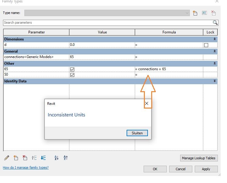

radu.sebastian.pn
Hi and thank you for your answer.
Am I missing something?
Message 5 of 11
Yep. Read this: https://revitforum.org/showthread.php/1046-Revit-Formulas-for-quot-everyday-quot-usage
You can't do that. First, is that a <Family/Types> Parameter (e.g. "connection<Generic Model>") or did you title it that way -- with the <Generic Model> a part of the name?   If you did name it that way, use the whole name and put brackets ( [..] ) around it in the formula -- and get rid of the equal sign for "<" or ">".
for instance: if(and ([connection<Generic Model>]>64.99,[connection<Generic Model>]<65.01, 1<2,2<1)
If you are trying to control which <Family/Type> is used, then read the second Link I posted you to above. Works like a charm for many years.

radu.sebastian.pn
Thank you @aleksandr.b. Is exactly what I want but I am receiving this message:
Message 8 of 11
Ilic.Andrej
You re missing more family/type parameters... In the example bellow, "Type 1" is a name of a family type parameter that has a value "Type 1". Then, Family/Type parameter "Dropdown List" is compared with family type parameter "Type 1".  I wish we could use a simple condition like the one you showed, but all we have is this dirty workaround.

radu.sebastian.pn
Thanky you very much @Ilic.Andrej !! A lot of nice people here !!
It took a while until I got it but finally... 😀
