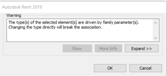

I am trying to control a long list of yes/no parameters that are setting the visibility of a number of custom grid layouts in a titleblock. I have made the Grids nested Gen Anno families and would rather have a pulldown in the titleblock properties rather than a long list of check boxes that you would have to check and uncheck. I have tried a number of formulas to no avail. Attached is a sample screenshot of a more simple version. tiaAnnotation 2020-07-01 184933.jpg

  1. Create some different Grid (can be different types or different families) and load them into your title block.
  2. Place one of the Grids (Generic Annotation) in your title block, select it and click the Label dropdown menu and Add Parameter.
  3. Load your title block into your project and it is ready to use.

@bin Thanks that does work as I just made grid types in one family, however if I have other Gen Anno families loaded into the titleblock, is there a way to filter out other families from the dropdown?
Message 6 of 10
If you use Family type parameter already then why you even need yes/no? Just create the grid configurations as different types in the gen anno family, or as different anno families, then nest in the TB family and use the dropdown to switch.

@ToanDN  Yes this is what ended up doing as mentioned with a previous reply, for some reason I was getting this error when linking the label. I was able to finally get it to work. thanks!
