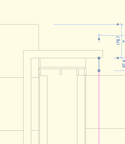

Hello!
Someone know I have to connect rails between stairs and floor like in attachment?
Do not know if is it possibile however try to ask.
Thank's!

Select the Railing
Drag the line of the path to line up with the other railing
Accept the sketch
Repeat with the other railing. Make sure to lock.

Sketch your rail as one. See picture.

One of the reasons why i look very much forward to trying Revit 2018, which should have a better solution for rails.
Your problem, however, should be fixable by doing a combination of the answers above.
For the part of the handrail attached to the stairs, select "edit railing". Now instead of selecting the existing railing path and extending it, you should add a new path (ie. a new purple line), which extends from the end of the existing railing to the railing which you want to extend. Then, from the properties panel, make this short part of the railing "flat" - which should fix the height issue you are having.

@Anonymous "Then, from the properties panel, make this short part of the railing "flat" - which should fix the height issue you are having."
is on revit 2018?
I haven't "flat" to refered.
Nachricht 9 von 10
als Antwort auf: Anonymous
Sorry, my screenshot was a little inaccurate :leicht_lächelndes_Gesicht:
It's up here (Revit 2016):

To add more handrail/top rail types go to your Project Browser -> Families -> Railings -> double click on any of them and in the next pop-up window, duplicate, give it a name and assign a profile.
To add more profiles, create a new handrail profile family and sketch a custom profile to suit your needs, or update existing one in the similar way described above, but going to Profiles Family instead of Railings in the Project Browser.
