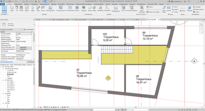

drived me crazy.. has apparently something to do with the floors, when I make them transparent the colors appear, but also appears the room (x) cross thing ..
here in the image the colour appears where there is no floor (clear storey, not yet seperated through room lines) also filling the base of an RPC! ????!
HELP!

hi @cbcarch , nope it did not work, yes the colours are there when I hide the floor they appear (but together with the X room symbol lines) ... there is nothing exceptional in the geometry..

@barthbradley it is the same in other floors, i created a wall rectangle here in the image on the left and worked there because there is no floor placed.. can there be some sort of conflict between rooms and floors?

Looks like your floor has surface material set to solid white. This is what hides the room color.
Message 10 of 10
thanks @syman2000 !!! perfect!!!
