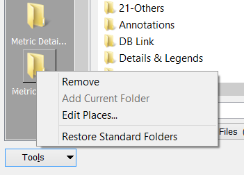

I want to place some colomns in my Revit drawing but i only have access to one?
I can only select the IPE-200 colomn. Where can i find the others. I'm sure i have installed all content center correctly.

Revit uses two types of columns architectural and structural. Load the family from the autodesk library you normally can find them in the subfolder "columns"  (architectural) and the subfolder "structural columns". All a bit depending on which libraries you have installed.
Louis
Thanks for reply but i can't find any of these subfolders, where are they normally installed in Revit?
L.Maas
C:\ProgramData\Autodesk\RVT 2016\Libraries\UK\Structural Columns
All depending on Windows version, Revit Version and installed library version.

I do not know what you mean with " i lost other columns in other libraries." Yuo can load different autodesk libraries without loosing families.
You just have to get familiar with Revit. Depending on what you want you can setup things to speed things up. First you can make shortcuts to your most used locations (places).
If you use the same families in different projects you also can make a project template with different families preloaded
You also can make your own family library. If wanted you can move/copy families from the default autodesk libraries to your own library.
