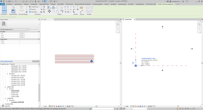

@barthbradley @RDAOU actually what I want to do is quite simple, in principle:
1- I prepared the project template with all views centered around a single family house dummy
2- I want to insert the Kadaster plan, to fit in my views, but with maintaining its correct coordinates (I would move the DWG attachment but dont want the coordinates to change) - I extracted the coordinates from the plan itself, but it did not allow me to move it around)
3- I want to create topography from the points file. It generates the terrain, but its positioned 20m away horizontally, and vertically, even though I typed in the height of the survey point as (-)566m it still creates the terrain 566m above the project level:
Nachricht 7 von 11
als Antwort auf: Anonymous
here: I have the EFH level set based on the survey point, which i moved (can see it to the left). but the level value is still 0.00

Do the "Z" values in the Point File represent an Elevation/Altitude above Sea Level?
If so, leave the Survey Point/Origin at the Internal Origin of the Project.
Create your Toposurface from the Point File.
The Survey Point/Origin is now representing Sea Level.
If you what to lower the Toposuface, go to Elevation View and move the Toposurface AND THE CLIPPED SURVEY POINT together.  Now, the Survey Point/Origin is still representing Sea Level.  You could, at this point, even place a Level (that has Elevation Base set to "Survey Point") through the Survey Point and name it "Sea Level" so that you have a Sea Level that you can reference when placing "Relative" annotations.
