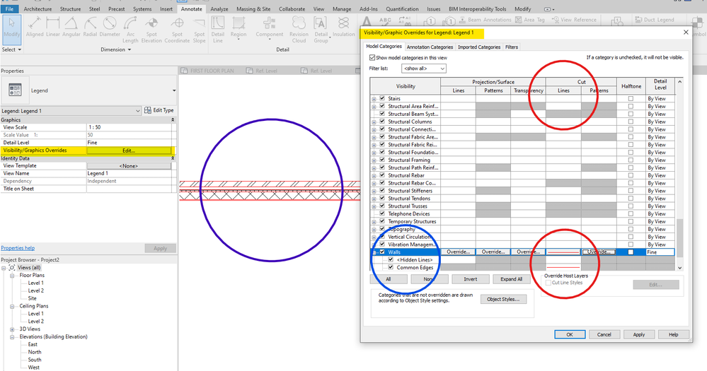

How to change the color of lines in Legend.
In the Floor plans, I managed to do it several ways, one of them is using filters, but I can't manage to get it done to color lines in Legends
Any help?

I'm afraid there is no way to do that, neither override by elements, do linework nor draw detail line over them. You will only change common lines (those between/inside layers) from legend's V/G overrides panel, fill core from Type properties (only will show in coarse detail level) or even create "colors" materials to show on layers, but no change lines display. Legends components are pretty schematic elements in Revit, probably it will more useful to "fake" the legend with a detail/drafting view and make all previosuly mentioned triks to show walls the way you want to...

@basheer.algohi
Like this... In Legend View >> Visibility/Graphics Overrides

@RDAOU, fine, I tested that but didn't work for me... Hope it works for you, @basheer.algohi

RDAOU
@jvpantin2
Im pretty sure it will work for him. If the option is there, it is possible...try it again, it will work for you too. Here is GIF

basheer.algohi
@RDAOU This works but still, the pattern is not colored.
But that is good enough
