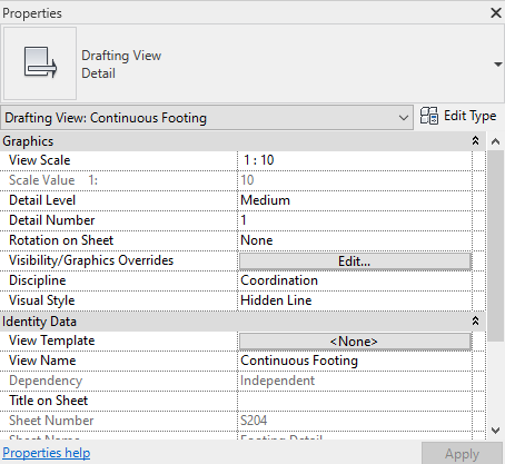

What you changed is the scale of CAD file.
You need to change the scale of the drafting view.
go to the view and in properties change view scale.Annotation 2020-01-24 154034.png

Message 10 of 16
@martijn_pater @MostafaElashmawy @RDAOU
so when I modify the scale factor I modify the dimension of .dwg file (pic 1)?
And when modufy "view scale "(pic 2) I modify the  View Scale in Drafting View?
Message 11 of 16
MostafaElashmawy
Yes you can say so.
