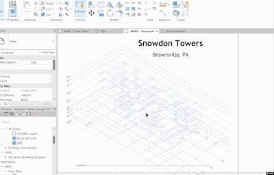

There is no straight forward way to do it no. Some of the workarounds
  1. Overlay two views on a sheet
    • View A: with the duct in Hidden Lines mode half tones
    • View B: with the duct category isolated and view set to wire frame
    • Place A on sheet then Place B and align them (See GIF below)
  2. Applying transparency to duct category (unless the system is isolated, some other elements might also show through
  3. Using Dynamo to place model lines along the duct center line
  4. Trace them manually
