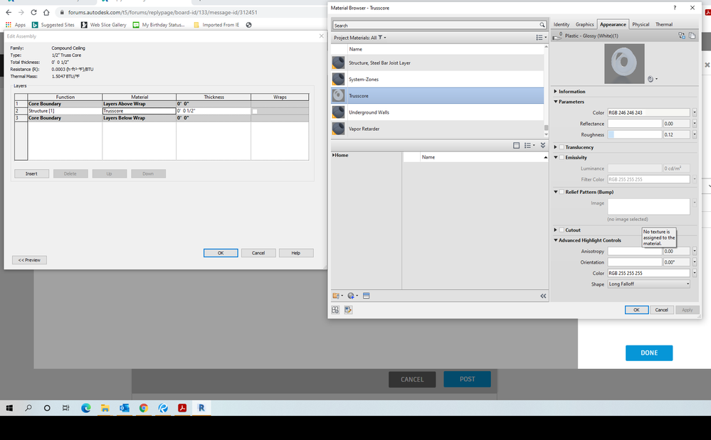

What Appearance Asset is the Ceiling using?  What are the Appearance tab settings? Post a Screenshot.
Shawnman1
