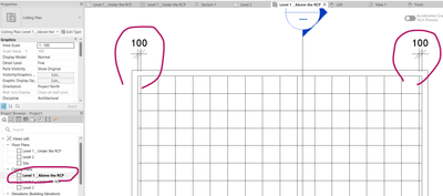

Greetings, dear. I am trying to add an elevation or dimension to the document, but Revit does not allow me. Most local views have been deleted. What exactly have you done to the file? The plans you provided are rendered images!
You can simply make a copy of your file, delete all the rooms, and keep this room with its ceiling and native views. You can purge the Revit Family to prevent sharing it, which will leave you with four walls and a ceiling, and the two views, one above and below the ceiling.
One more question, do you want the red and blue to match? right? If yes, then notice that the dims legs are not aligned with the ceiling grids. OR you want the top and bottom to match
Second, the grid lines are not matched in location between the bottom and top, which I believe is your primary concern
I have done this example _ 2 RCP plans: one to see under the ceiling object and the other is to at the RCP and it is above it (not the four squares are not showing as they are under the ceiling), look at the RCPs view range, they might help you, and the grid lines are the same
Try these settings, mate, and I am sorry I could not understand the Revit file you sent me, as it has pictures instead of the actual ceiling object in the 2D plan.
I am starting to suspect that you have a corrupted Revit file or template, as it sometimes causes such errors. Or your Dim legs were not accurately aligned to the ceiling grids, because I got in the file I built, both top and bottom are matching, and also both right and left grid ceiling lines are matching too (at the same view and in top and bottom).
Another suggestion, is to go ahead start the "Metric Default.RTE" build four walls and a ceiling, test the settings and see how the ceiling grids should act, if the same setting used in both files (the one you are working one, and the new one) then, you either has a curruted file, or you have added two ceiling in the same place, same location, each has different ceiling grids (so may be delete the ceiling itself and see if you still can see the ceiling grids), and finally check your dim legs are correctly placed and aligned with the ceiling grids.
