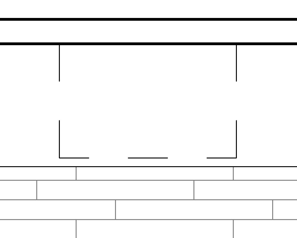

Hey everyone,
I'm having some difficulties with this casework family I made, and I was hoping someone would know how to resolve them. I've included some screenshots, as well as a project file containing the family.
Here we go!
The casework family is built in 3 parts (nested families). First, the Kicker (which is a basic extrusion), second the structure, and third the door(s). Each nested family has their individual instance parameters that are then controlled by the casework family (linked parameters).
The extrusions from the structure's nested family is set to "not visible in Plan/RCP". In this family, I added a Masking Region with "Hidden Lines Projection", in order to only see the outline of the casework in hidden lines. When inserted into a project, the structure of the block works flawlessly - showing the outlines of the casework with hidden lines in plan view, both when there is a counter above it or not.
I followed the same procedure for the door's nested family, but here's where I encounter issues. The door shows up as hidden lines in plan view, but the lines do not appear through (or above) the counter..
I'm going mad trying to understand why, and I know it must be something ridiculous!

This could explain your Door displays issue:
https://www.archilizer.com/2018/11/16/window-cuts-wrong-in-revit-solution/
https://knowledge.autodesk.com/support/revit-products/troubleshooting/caas/sfdcarticles/sfdcarticles...
Bottom line: Window & door families are not cut based on the cut plane defined in project views.  Instead they are cut based on the cut plane defined in the family's plan view.
Can you point me to the Family you are referring to that uses the Family Types Parameter?  Or post it separately?
Totally misunderstood before.
Uncheck "Draw in Foreground"  in Door Panel Family
