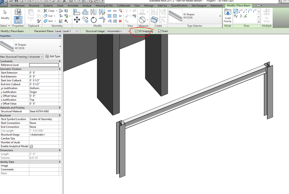

Hi, I am new in Revit and I am learning by myself,
Question:
I added columns and now when I add the Frame on top of them, doesnt wok, I can draw but when I click on Esc button, on the Properties dialog box, the Reference Level and Work Plane are gray out, that is why I can not add beams on top of the Frame. I can select them in 3D view but they are still not active.
I need a help please. Please view the attached fie
Nachricht 12 von 23
als Antwort auf: Anonymous
Tick 3D Snapping when you draw a beam at columns.
Nachricht 13 von 23
how can I do that?
Nachricht 14 von 23
See the 1st screenshot, after start the Beam command, tick 3D Snapping box on the option bar.
