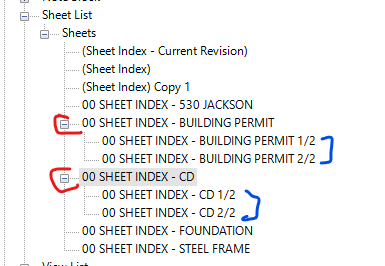

Pinned?  Or it maybe already splitted.  Place child schedule, not the main schedule.

Place the blue ones, not the red ones.
