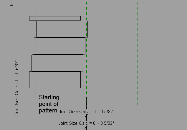

Even nesting a family isn't a solution some times.  I'm at my wits end trying to get a simple panel array to work in a curtain wall panel.  I get all the way to end only to realize I can't control the thickness of panels, even in spite of nesting them, because Revit wants to start shifting them out of position front to back for no reason.  I started the array over from scratch, got the thickness working, and lo and behold, now the width starts stepping out!  Every time I try to fix it I get an error telling me I have to delete all the constraints. And then top that off, I realize that while EVERY generic family puts "front" towards the bottom in plan view, towards the user, the curtain wall families put the "front" (exterior) TOWARDS THE BACK!!!
Looking at this picture you can't even tell the shape handles are aligned to reference planes, only if I change any parameters the nested family turns orange I have to delete it.  You guys did such a bang-up job with arrays in AutoCAD so what's your excuse here?!

As for the family I've overwritten the version were thickness didn't work so I don't have it anymore.  I've attached the current version where width doesn't work.  You can still see what I'm talking about when you try to control the width.  The panels start sliding from side to side.

Your earlier upload worked as required and the video was very helpful since it showed me what had to be constrained to what.  I forgot about the spacing reference plane which I should have remembered since I've built a couple ladders in Revit.  They were easy by comparison since the height and depth of the rungs were fixed and only their length needed to change.
One thing you missed, the array number needed to be set to Panel Number, not Panel Integer. Without all those if/then statements the family tries to create a remainder panel of 0" height when then total array height is a whole number of feet.
