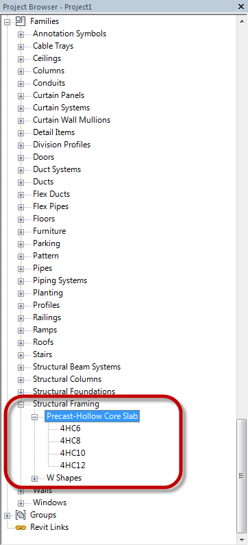

David_W_Koch
Precast-Hollow Core Slab.rfa is a Structural Framing family.  You would have to place it as a Structural Beam.  (Most likely, multiple Structural Beams.)
Floors are non-loadable system families.  Unless you really need to model each plank, you could create a Floor to represent the precast, hollow-core construction.

You may be able to place multiple parallel instances using a Beam System.  I was thinking of placing them one-by-one using the Beam tool, on the Structure ribbon tab, on the Structure panel.
If you choose to place it as a Beam System, you would have to specify the Precase-Hollow Core Slab type in the Properties palette:  not in the Type Selector at the top, but in the Beam Type property, under the Pattern category.  You will also need to adjust the spacing to match the width of the precast framing member selected.
Here is where the family ends up in the Project Browser.
