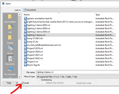

bill_gilliss
Try auditing the model next time you open it. To open it, DON'T click on the file on the Recent Files launch screen, but use File > Open and check the Audit checkbox:
