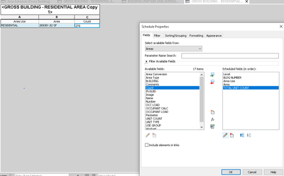

I have a schedule (image attached) where I am trying to calculate the average residential unit size for each unit type. The schedule has been collapsed (as in, I unchecked Itemize Each Instance in sorting) so that the Area is a grand total for that type. The problem is that some of the unit types have different areas, which "breaks" the schedule. Does anyone know how I can approach this issue? I created an "Area - Unitless") parameter, which is a calculated value of Area / 1 SF,. and the My Count parameter, which is a number Type parameter where I set the value to 1 (to be able to use the Count value).

@ToanDN  Could you help me out with how I can calculate average area from the total residential area under Area use. I set the total unit count as a Parameter data and input the unit count.  Some how the formula I used , Area/Total Unit count, gives me "Improper Boolean expression". Appreciate the help. Thanks!

Total Unit Count is a text parameter.
Revit does not use text parameters in calculated values. Change Total Unit Count from Text to Number

N_Vishak
That worked !!! Thank you 🙂
