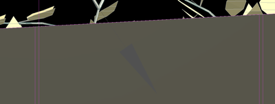

When editing a wall to create wall panels.
Say you have a cladding panel that is eg 1200mm x 3000mm, and you want those panels to have a gap of 20mm between them.  The top lines of the panels keep automatically moving one line in the gap to the adjacent line, closing the gap when you try to fillet the corners, particularly when the top line is at an angle.
When you fillet this:
This happens:
There used to be 2 vertical lines here, but the one on the right automatically moved to the one on the left.
I can't see where where that suggests the lines are locked together, so I don't see a reason why the lines of individual "rectangle cladding panels" should automatically join together.  They should remain as individual lines that can be trimmed, filleted, etc...
The trim function ends up with the same problem.
It only seems to happen when the top line is at an angle.

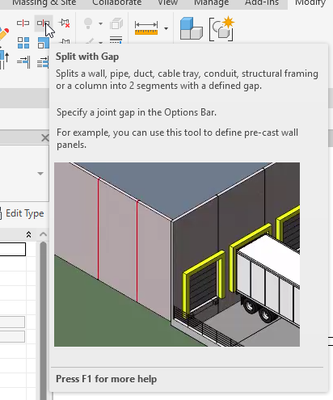

Split Gap is intended to be used on a select few kinds of elements such as a wall to create a gap of a specified width, to simulate tilt-up concrete walls for example. See image for the list of elements it works on. The Split tool's option Delete Inner Segment will allow you to pick twice and delete the segment between those pick points, which creates a "gap".

Actually, in 2026 the command has MORE options:
vs. 2018 where it could only split walls:
Make sure your Revit is up to date, and so is your windows, .NET and Nvidia drivers.
