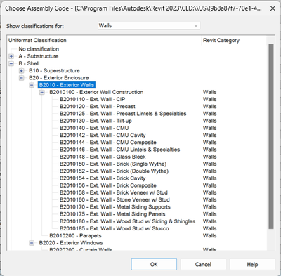

Our project currently uses Uniformat assembly code:
We want to switch to Masterformat for spec writing purposes.
We don't understand what will happen to the project once we upload a new assembly code file. The Uniformat system classifies entire assemblies but Masterformat classifies individual assembly parts (i.e. metal studs, gypsum wall board, etc).
Would a wall that has multiple parts show multiple masterformat assembly codes? Is that something that is done?
Thanks for any help.

What do you mean by "switch" to Masterformat? You cannot. They are two entirely different formats. Assembly vs. Keynote.

I understand that one can use the Autodesk Standardized Data Tool to assign Masterformat numbers to elements. I have managed to get this tool running on my build and have successfully assigned a class to an element.
But given that the element is a wall assembly with multiple components, how do I assign masterformat numbers to each component in the assembly?

If you want to keynote individual components then use material keynote or create parts.

How would I go about adding a new keynote to the Masterformat keynote file downloaded by the tool?

You need to edit the source file and add value to the description column.
