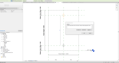

I am trying to array a face-based nested family consisting only of voids on a curtain wall panel. I intend to make different pattern families that can be swapped via a label parameter (not currently present in the attached family).
When I do make the array the dialogue "Instance origin does not lie on host face. Instance will lose association to host" pops up and the arrayed instances of the family do not cut the curtain panel wall. See screenshot below. I've also attached the curtain wall panel family.

Try this one.
I don't know what the game plan is, but what about skipping the middle-man and just creating and arraying a void directly inside the Panel Family?

Thanks! The void array works as intended. What was the issue? I'm still somewhat new to Revit and am genuinely interested in mastering family creation.
I've since introduced a label parameter so that I could swap nested pattern types. However, when I apply that pattern label to the nested family instance I get a msg that "Reference Planes are overconstrained." and then it no longer is able to generate an array that reacts dynamically to the height of the curtain panel. See attachment again with additional pattern types.
