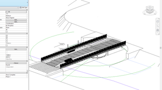

Is there a way to "animate" things in Revit?
Actually it is not a real animation but I have to display a bridge open and closed.
I want to do it without copying the model (several linked types of bridges).
Maybe with phasing?

chrisplyler
You could use Phasing.
Or probably more appropriately, you could use Options.
Make an option with the bridge open, and make an option with the bridge closed.
Message 5 of 17
-FDC-
Thanks, this can be a workaround but I still have to copy a second (open version) of the bridge (this is actually the same as hiding something).
Or am I wrong and missing something?
I am searching for something like :
View A: closed bridge
View B: same model but rotated, open bridge (other phase)
I probably have to do this in Max.

If the bridge is a family you can assign a rotation parameter and rotate it on the fly with a slider.

View A - set to show Option A, which has a closed bridge
View B - duplicate view A, but set it to show Option B, which instead has an open bridge

Project was a case study for different (5) type of bridges.
I think @ToanDN provided the best answer but my bridges aren't modeled as families.
They are all separate projects which I then linked in the "scenery project".
The goal was to easily import the scenery in Max (which worked quite nice btw).
Render the whole, re-import the Revit file but now the Rotated view and render again.
I wanted a revit view with a rotated bridge and a view with a non rotated bridge but it seems that isn't possible without making a copy.
Now I had to render the whole, do a rotate in Revit, re-import it again in Max and re-render.
No big deal but the railings are autocad objects (export from sketchup) and gave some problems.
Result could have been better but because of the lack of time and changes to the designs it was good enough.

I think that we can assign elements into a specific phase and then automatically running it by Dynamo.
Dynamo is used for controlling Phase Created in Properties Pallete. It seems to be smoother than the mount images.
