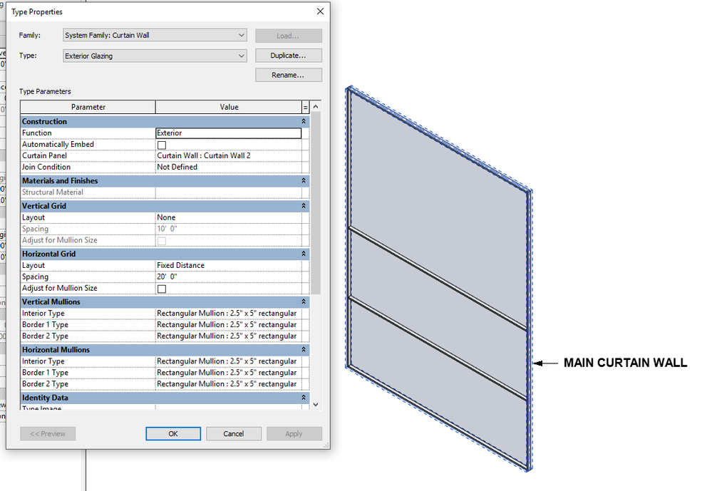

Edit the main curtain wall profile, or attached to a roof/ floor/ ref plane.
Message 12 of 27
@chrisplyler
And I need to clarify that this method is for when you need a just few off-the-rule grids like the one @pcfarnan13 shows in his photo.  If the entire grid needs to be flexible, then creating a curtain system based on a divided surfaces using intersecting reference planes as you suggested is the way to go.
By the way, below is an example of changing a curtain wall top by attaching it to a ref plane.

Giovanni-Barbari
Hi and thank you for helping out on this.
I have a question. On step "2" where you say to Use Another Curtain Wall type as Panels. I am not understanding how or what to select and switch over? Can you please provide some more detail on that?
Thank you,
Message 18 of 27
dem0s
Look, I think I got it and since I was in the same boat as you when searching for this issue, am going to explain it to you cause the explanation here is a little vague. The main point that you should keep in mind is that you are going to work with the panel of your original curtain wall. Just select a panel in you curtain wall and unlock it. Now you are going to change this panel. In the list of the panel you can see that you can select a curtain wall, select it. And this is the way that you are going to work, with a curtain wall inside a curtain wall. Now you can change the angle of the mullions of the curtain wall inside your original curtain wall.
