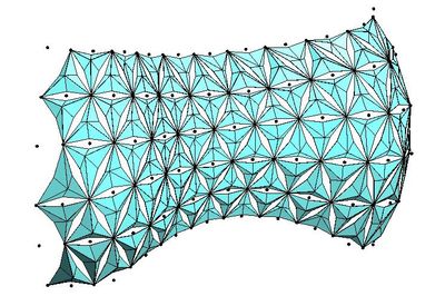

Nachricht 10 von 10
FAIR59
als Antwort auf: Anonymous
Forget the divided surfaces. They won't work as there are surfaces of different "height".
The best solution I've found, is to use divided paths.
  • Select the bottom edges of the surfaces, divide path.
  • Select the top edges of the surfaces, divide path.
  • Draw a number of (reference) lines onto the surface, using spline through points.
  • Select all new lines, divide path.
  • Select all divided paths, assign fixed number, and a number value of your choise.
  • Place your curtain panel on the appropriate points of the divide paths, and make repeater.
Result:
