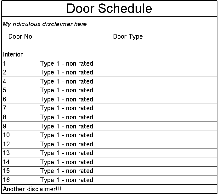

You can add rows below and above the header row. Click the header row and insert above or below. You also get all the other editing tools like merge.

You could customize your Grand total to show some text. But it won't work when you need actual Grand total and count there.

I believe you used the "Custom Grand Title" for the disclaimer? If so, I think so far I followed you.
If no one else comes up with something else, I think this is a good workaround. I still like Adesk to come up with a more direct way (and one that doesn't take the count function away)
