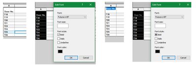

1 schedule column has a bold fond?
Hellow
has anyone an idea why somethimes my colum fonds has a checkmark like this
and sometimes this
an dhow can i choose between both? because when it is the second screenshot my hole collum is bold but when it is the first screenshot its only my title

You don't choose which mark it is. The mark is based on what you have made bold.

If you select a whole column by clicking on the 'A' and change the font it will change the body and header font type and show a checkmark.
If you select just the header and change the font to something different than the body font and then select the whole column again by clicking the 'A' it will show a dash or filled box indicating that the value varies within the selection.
The 2 left images show the column being all bold font. The right 2 images show the header is not bold and the body is bold.
