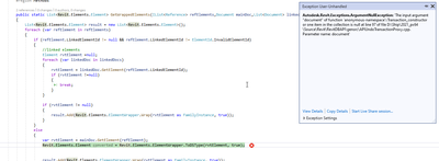

I still get this error
and i think i need to initialize documentManager instance
am i right? or do you have any idea about what should i be looking for?

after digging 6 hours into this problem. I was able to make it work.
it needed to setup an environment like a dynamo environment.
here is my code sample in case anyone needed it.
