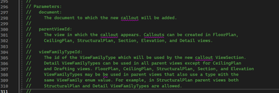

I am using ViewSection.CreateCallout() method and passing the document and my areaplan ElementId for parent view  and pass the viewFamilytypeId that is I am getting from my parent view and min and max point but I get exception " Non-Reference callouts are not allowed in parent views of this type".
In the summary of this method so of viewtype are mention but Aeraplan is not mention so. Is there any way to create a callout for areaplan. it becasue to create a callout in revit using callout option. how to do that using API.

@jeremy_tammik Thanks for the reply.  I am already employing this workaround to create the area plan with a crop box from the bounding box.  It would be nice if the dev team could respond about why the ViewSection.CreateCallout method doesn't work in an area plan even though it does in the UI.

Check the documentation, https://revapidocs.com/2020.htm?id=272ce735-271e-6ae3-8b36-c31207c99e56.htm
As a AreaPlan is derived from a Viewplan it should work, but I think  "doc.ActiveView.GetTypeId()" should not be taken from the AreaPlan but a valid FloorPlan is my guess.
Inspect the callout created in the UI with RevitLookup and see what it uses.
