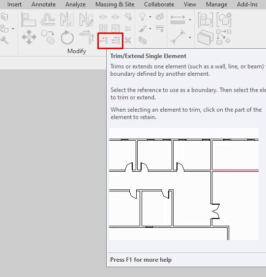

 Hi guys,
I'm trying write add-in to extend beam into face of column.
But, i can't find any something about Revit API to action
How can i solved this issue ?
Many thanks.

kevin.anggrek
I also want to know further about this issue. I am currently interested in extending one Line element to another.
For example I have 2 simple lines such as shown below:
XYZ ptA = XYZ.Zero;
XYZ ptB = new XYZ(10, 0, 0);
XYZ ptC = new XYZ(5, 5, 0);
XYZ ptD = new XYZ(5, 10, 0);
Line line1 = Line.CreateBound(ptA,ptB);
Line line2 = Line.CreateBound(ptC,ptD);
 How can I extend line2 so it touches with line1? I tried looking at the SDK Documentation and the revitapidocs for Lines, Curves, XYZ and I still have no clue. I find something called TrimExtendCurves Method but don't know how to use it properly, if it is limited to Rebar elements only or if it is even relevant with the current issue at all.

vkelani
@kevin.anggrek
you can get the intersection of two lines P(I), and check the distance of between intersection points and each end point of the line you want to extent. Whichever is short distance, you can replace that endpoint it by P(I) in create line bound.
you’ll get the desired extension.
@mr.engineer.aec  same concept can be applied for walls and columns, I am not really sure what geometry element they are but you can use RevitLookup to see the geometry type and create the logic.

RPTHOMAS108
Can probably find the intersection via Line.CreateUnbound you'll get the direction from each line by deducting one end from the other and then normalising the XYZ, origin can be any point on the line i.e either end point.
Above is for straight lines if you have arcs then you can do similar but you'll have more than one intersection, however  only one of those intersections is nearest to the original end of the beam considered. You can't create an unbound but you can create one that is between 0 and 2Pi.

kevin.anggrek
Thanks to everyone for the replies
@RPTHOMAS108,
Thank you sir for the detailed explanation, by using CreateUnbound, I can basically elongate the line and find the intersection points that I need. Then, I can change the endpoints to the intersection point as a way to extend the line just as explained by @vkelani.

mr.engineer.aec
 Many thanks all replies.
At the end, don't have any method to action.
I think i'll get end point and project on to face.
Although it seem manual but i think it can be useful.
