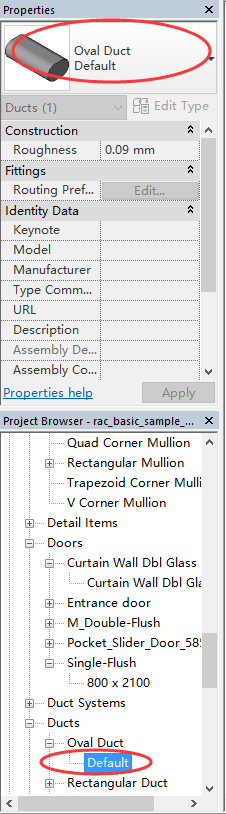

Is it possible to trigger the Property Dialog(the first image of my first post) ?
Message 9 of 12

thank u  but i wan to triger the properties dialog to react a new loaded family that havn't has any instance , like if if select a familysymbol in the Project Browser then the properties dialog react to the family.
Message 11 of 12
Revitalizer
sorry, no more ideas.
Perhaps you can place a dummy instance in a temporary transaction after loading the family.
But I fear that if you delete it, the properties palette will react instantly and switch to another element's properties; having a void selection, this are the current view's properties.
I think, it's not possible.
