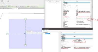

Do you mean create it manually in Revit ? Yes I can create it manually in all ViewTypes (2D plan, 2D section, 3D,...), in my test I'm using a basic ViewPlan.
I've analyzed above in the discussion (using Revit LookUp) the parameters of the point created by hand and I tried to do the same thing using code, I've achieved to get the same objects which have the same IDs and are of the same types, but impossible to create the point...  (Below a new example)
This is a point created in Revit manually :
This is the reference property I get using code :
I must specify that  that, it work on objects of others types (with just a correct X-Y, no need to specify Z) but not on TopographySurface objects.
Either the API does not support, or I missed something...

RPTHOMAS108
This has come up before, you can't add a spot elevation to a topo but you can copy one onto it from another temporary location using ElementTransformUtils.
https://forums.autodesk.com/t5/revit-api-forum/how-to-create-spot-elevation-on-the-topographysurface...
If you create a DirectShape at the model origin you can host the temporary spot elevation on the top face of this at 0,0,0 and then copy to the coordinates on the topo. To find such coords you can use ReferenceIntersector. Need to use a surface reference to host the temporary spot elevation.
