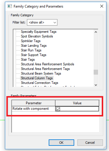

Hi All,
I created some rebar tags and set a custom tag position. When I defined them, I set the orientation to "Horizontal" for horizontal bars and "Vertical" for vertical bars. They are well done created but when I want to order the leaders in my view, if I take the elbow or the leader end it always changes to a horizontal position.
The "Orientation" is still "Vertical" but the text is flipped horizontal position.

hi, go to the family editor (edit family) of the rebar tag and go to the "family category and parameters" window.
try to uncheck the setting "rotate with component".

Hi @so-chong. Thanks for the quick reply. As a matter of fact, I have this option checked, so what else could be causing this?

That is the option you don't want ticked, if you don't tick it you can set horizontal or vertical explicitly in the pull down that is currently greyed out.
When tags don't have a leader they align to the element with this option e.g. beam references. If tags have a leader the horizontal or vertical orientation changes according to position from leader.
However if you remove the rotate with component then you can explicitly set horizontal or vertical and I believe (from memory) that isn't then affected by leader location from tag. My problem with leaders for rebar is that they start from the centre of the tag text and not beneath it. I tend to turn them off and put in an annotation family line (details lines don't extend beyond the crop). Annotation lines are awkward however since you can't have grips and therefore need to trial the length values.

Hi, Richard explained it very well what happens if this options is enabled or disabled. To give you an idea how this may look like i made a screenshot.
on the 'left' side of the screenshot the option is disabled and the tag remain vertical, on the 'right' side the option is enabled and the tag will rotate horizontal automatically when you try to adjust the tag manually.

Thanks, @so-chong and @RPTHOMAS108. I misread the first response. My bad. This was actually the solution that I was looking for.
