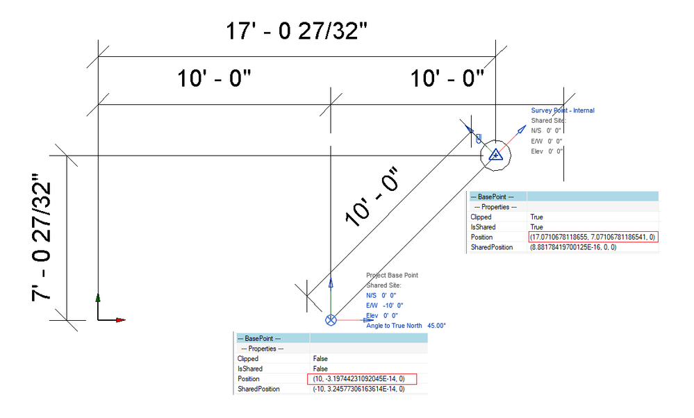

Below is some further explanation of how changing the base points has no effect on the internal system and it may help understand the changes that take place. I'll use SBP and PBP in place of Survey Base Point and Project Base Point.
In the first image I have moved PBP 10' east and SBP 20' east. When survey point is clipped you are moving the survey origin with the base point. Within Revit lookup we see Positions of 10 and 20 from the internal origin. Shared position can also be seen but that isn't the internal system.
In the second image I have rotated angle to true north on the PBP and it can be seen that the SBP takes up the position expected on screen. The internal system is still parallel to project but the shared system is now at 45 degrees to project and internal. Also can be seen that the position property in RevitLookup is measured from the internal system (same as before for PBP now 17' & 7' offset for SBP). You can also see that PBP 'SharedPosition' property measures as -10' down the diagonal.
Lastly I unclip the SBP and move it 5' towards PBP. You can see that shared origin remains where it was (the PBP and SBP give the offsets from it you would expect). The 'Position' property is still measured correctly from the internal system which has remained consistent throughout.
So in summary if you want to convert between survey coords and internal coords use the approach from the link in my initial post. If you want to convert between project coords and internal coords then set up a transform based on the Position property of the PBP (noting that the project system is always parallel with the internal system). My further observations tell me that acquiring coords from a DWG doesn't change the positions of the base points themselves just the offset and rotation from true north parameters.
