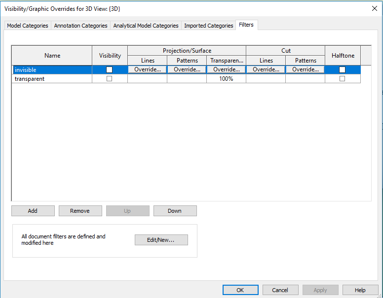

Hi!
I check visibility of surface with code:
surface.IsHidden(doc.ActiveView)
But I have a surface that is not visible in the view. At the same time, the previous code returns "False."
The fact is that this surface is hidden by "Visibility/Graphics..." filter, like a screen:
How do I identify such surfaces?

AndrewButenko
Hi Jeremy!
Looks like I found the solution myself. I use the following code:
 Public Function IsElementVisibleInView(View As View, el As Element) As Boolean
' Obtain the element's document Dim doc As Document = el.Document
Dim elId As ElementId = el.Id ' Create a FilterRule that searches for an element matching the given Id Dim idRule As FilterRule = ParameterFilterRuleFactory.CreateEqualsRule(New ElementId(BuiltInParameter.ID_PARAM), elId) Dim idFilter = New ElementParameterFilter(idRule) ' Use an ElementCategoryFilter to speed up the search, as ElementParameterFilter Is a slow filter Dim cat As Category = el.Category Dim catFilter = New ElementCategoryFilter(cat.Id) ' Use the constructor of FilteredElementCollector that accepts a view id as a parameter to only search that view ' Also use the WhereElementIsNotElementType filter to eliminate element types Dim collector As FilteredElementCollector = New FilteredElementCollector(doc, View.Id).WhereElementIsNotElementType().WherePasses(catFilter).WherePasses(idFilter) ' If the collector contains any items, then we know that the element Is visible in the given view Return collector.Any() End Function
