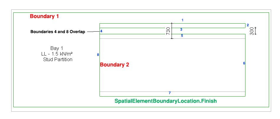

Hi
The attached image shows a selected Space object with 3 boundary loops (one outer boundary, two inner boundaries).  When I attempt to get the boundary segments of the same Space through the API, only two loops are returned as you can see from the bottom part of the image.  Reading the following post I can see that there are unresolved issues with Room / Space boundary detection when it comes to small tolerances but in this case the UI has successfully determined 3 boundaries whereas the API only returns 2?  I'm running Revit 2017.2.  Attached is a sample file.

Here are some things I tried with varying results:
  1. Set SpatialElementBoundaryLocation to Centre – Results in 2 boundaries each with 4 segments (see image 1 below - there are separator lines between the two bottom free standing walls BTW).  Has the effect of ignoring the top single leaf wall (I assume because it’s a standalone wall and its centre line forms no closed loops – expected behaviour I guess).
  2. Do not set SpatialElementBoundaryLocation (defaults to Finish) – results in 2 boundaries, outer with 4 segments, inner with 8 segments that overlap (See image 2 below).
  3. Set SpatialElementBoundaryLocation to Finish – same result as above.
  4. Do not set SpatialElementBoundaryLocation (defaults to Finish) and increase the distance between the walls by 10mm to 310mm - Results in 3 clean separate boundaries all with 4 segments.  (See Image 3 below).  This is the result I want.
  5. As 4 above but set SpatialElementBoundaryLocation to Centre - Results in 2 boundaries each with 4 segments (same as 1 above).
So, because it’s the inside face I’m interested in, SpatialElementBoundaryLocation.Finish is the setting I need and by slightly increasing the gap between the walls to 310mm the API returns what the UI appears to indicate on the screen (when selecting the Space).  Doesn’t help me though because the gap needs to be 300mm or less!  I’ll have to try and detect this scenario and extract the two boundaries from the returned overlapping inner boundary (perhaps using the Clipper library).
Correcting the issue by moving the wall does point towards a tolerance issue but its annoying that the UI and API return different apparent results.

Thanks for running it by the development team.  Attached is a sample file.  I have moved the relevant Add-In code into a Macro which is self contained within the file.
  1. Open file (2017)
  2. Macro Manager, select Macro DrawBoundaries
  3. Select the Space (there is only one drawn in the model)
  4. The macro will draw the boundaries as model lines.  Note that there will be two boundary loops as detailed in my post above (there should be 3).  The API has incorrectly combined the two inner boundaries into one loop with overlapping segments.
  5. Undo the changes to return back to a clean model.
  6. A "Fix" is to increase the gap between the two top walls.
  7. Move the top standalone wall up by 10mm thus creating a 310mm gap.
  8. Re-Run the macro
  9. The API now correctly detects 3 Boundary loops which is the desired result.
  10. It's easy enough to debug through by placing a break point at line 65 and observing the segArray count.

The development team finished analysing your issue REVIT-127340 [API space boundary differs from UI -- 13927409] and say:
A.
This is an excellent reproducible case!
I reproduced the issue and investigated the code a little bit. It seems that the root cause has to do with the topology of the room. The API function called to retrieve the segments depends on the previously computed topology.
To trace the code, I put in breakpoints and ran the macro. I also changed the dimension from 300 to 310 and back.
I traced how the topology is computed...
I can see that depending on the position of the stand-alone wall (which is offset by either 300 or 310 mm) the topology switches between two components and three components. It looks to me like the stand-alone wall produces a possibly degenerate two-segment circuit that is sometimes combined with another circuit to make a circuit with six segments.
Since the algorithm has many cases (needed to support different kinds of geometry) and includes tolerances and performance optimizations, I think that fixing this issue should be classified as an improvement.
B.
Actually, there is no difference between boundaries used by the UI and API. The boundary is less than ideal due to the 1ft (about 300mm) gap closing tolerance. The space in the model here also has those overlapping lines on the left side of the "islands" except they are not displayed in 2D view. Internally the same code provides the boundary curves to the Space/Room elements as the one used by the API.
Nothing really to fix here, except the old problem of the 1ft tolerance. That has been reported numerous times and waiting in our backlog to gather enough support.
I therefore closed this issue now as 'Won't Fix'.
