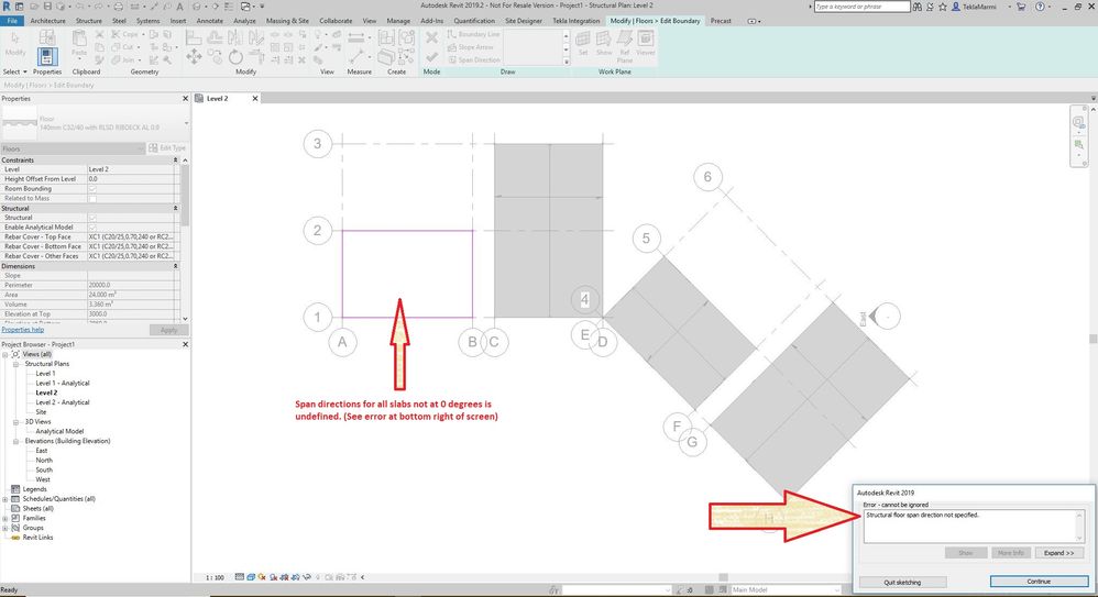

We are currently experiencing the same issue.
If you try a non-zero value then the Structural Floor Span Direction does not seem to be set when you attempt to edit the slab geometry (Modify > Edit Boundary > Select green tick without making any changes) - see error that occurs in screenshot below.
Please note that when you show the slab direction using Annotate > Span Direction > Auto place ON, the span direction symbols are added as you would expect. Span Direction.JPG

spanDirection is not set set in the scketch plane when changing SpanDirectionAngle property.
RPTHOMAS108
Yes seems like an error. However as a workaround if you change the span direction in a separate transaction after creating the slab then the span direction line is correctly created (use of a subtransaction doesn't resolve the issue in the same way).
This is a rare example of being able to do something in the API that you can't do in the UI i.e. complete a slab sketch without a span direction line.
