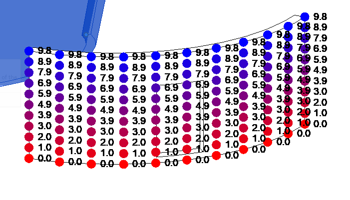

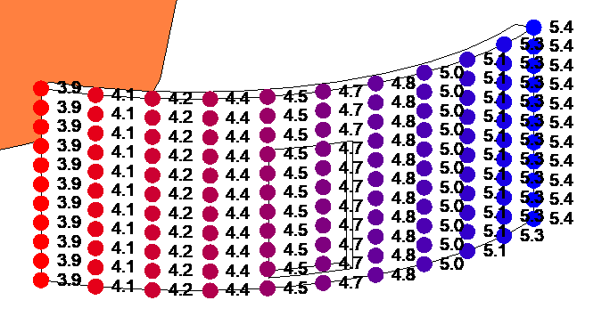

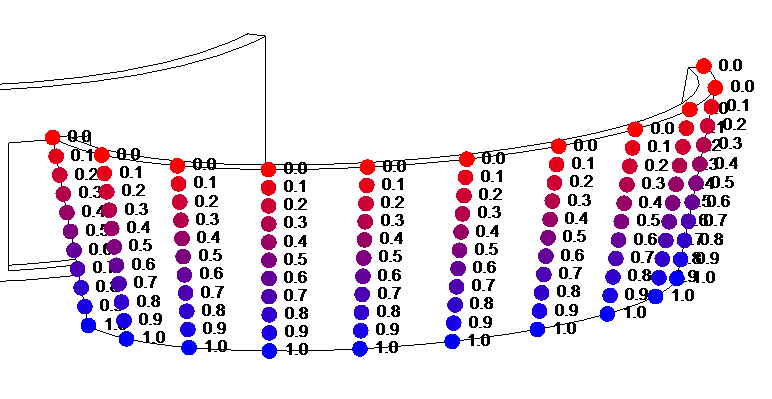

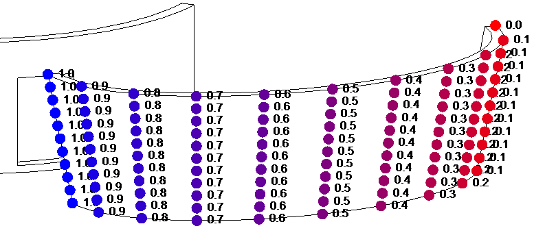

Actually I recalled wrong, results as below:
Generally the UV is based on raw parameter of curved edges but for some faces i.e. ruled face it is normalised. Below are some examples (note the direction of increase in all cases). The below is based on difference between Face BoundingBoxUV Max/Min (dividing into 10 segments and adding the UV values to the ValueAtPoint collection). Many of the walls below are 9.8ft high with base at 0.
PlanarFace UPlanarFace UPlanarFace VPlanarFace VRuledFace VRuledFace VRuledFace URuledFace UCylindricalFace UCylindricalFace UCylindricalFace VCylindricalFace V
Message 13 of 15
RPTHOMAS108
This seems logical to me in that a Ruled face has to transition from one curve to another (opposite edges) so it makes sense for those two opposite curves to be normalised so the points along it can be mapped to one another. Imagine otherwise you would have an arc at one edge opposing a line at the other (both with different lengths) you would have to normalise at some stage.
At the same time other types of faces such as cylindrical face / planar face may be constructed with a curve projected in a given direction by a length, so raw parameters also seem more appropriate for that form of construction. Regarding cylindrical face you can also see the U-Value are related to the parameter of the curve i.e. that curved wall is obviously longer that 1.5ft if it is 9.8ft high (so needs to be multiplied by it's radius).
I always prefer normalised curve parameters they inherently tell you more and tell you everything when combined with a length and start point. I know what my preference would be but I think we just get the leftovers of the internal geometry system.
